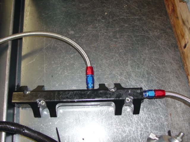

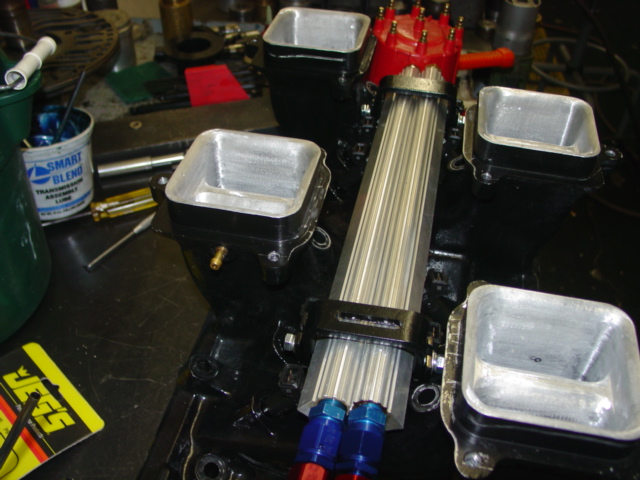

Why not put the bigger injectors in your current motor and turn up the boost or are you at the limit already,Smitty
