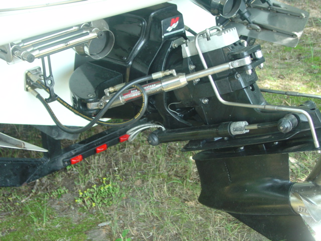

Part for part there is no question a b-max upper is better,it has much bigger gears,bearings,thicker case etc. As far as the lower goes,they are both pretty much using xr gears that have been through a surface treatment,be it cryogenic or hardening,coating etc.
I personnally have a max worx drive on my boat AND one for a spare. I was going to buy a B-max when I bought my spare max worx drive,I called up B-max with my credit card in my hand in june a few years ago (I had sheared off my vertical shaft driving like a retard and needed a drive in a few days as I was leaving on a 2 week vacation) and they told me 6-8 weeks,maybe 10!! I asked them what happens if I were to break something,what is your turn around time? I don't remember what the answer was but it seems like it was also 4-6 weeks. Our boating season in MI is only from mid june until beginning of sept usually,10 weeks,sometimes longer,and I cannot and will not wait. I ordered one from max worx new and complete,it was at my door within 3 days. Your boat is lighter or at least the same weight as mine and I doubt your 454 with even 10 plus lbs of boost is coming near the power output my 540 running 10 plus lbs of boost is making,I would expect a max worx drive to last you several hundred hours. When I only had 750 hp,my max worx drive lasted very long between breakdowns. There are several guys who have had breakage problems with them with less power than I'm running BUT there boats weighed nearly twice as much as mine or more. At the power level I'm currently at (950 plus ft lbs of tq) I am only geting 20-40 hours of life out of lower gears,which is un-satisfactory but Max worx is developing a set of lower gears made from some kind of 9310 alloy that will probably last,just waiting on them to finish testing them,Smitty
