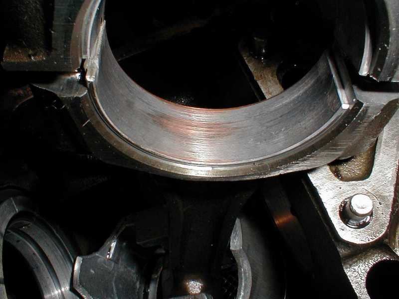

My Nitrous screw up,lean.
When I tore down the motor it didnt show any signs of detination in the top of the rod bearing.It showed a little crank flexing on the outer edges of the mains,but this was a 425hp shot on a 358ci engine.It also didnt push out the head gasket either
It only showed 50% leak down on that hole
