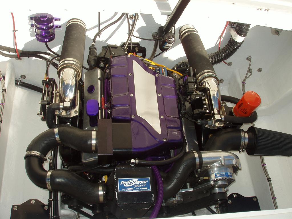

Here is a pic,Smitty

How do you even work on that engine. Here's what a single engine 28 bilge should look like!!!
Seriously, thank you for all your time and help to date Smitty. Hopefully I'll get this engine right from the beginning thanks to all your input and advice.

Ok, some of us only run our boats under full boost 10 or 20 hours out of 100,kurt runs his at full boost 97 out of 100 . 20 out of 100 hours on my boat are going thru no wake zones,majority of my boating is cruising between 45 to 65 mph at zero boost but the blower is definately pushing some extra air to get the boat to cruise there with a 30 or 32 pitch prop,Smitty
Kurt-don't ever let my son see your engine compt or he will commit mutiny on me,he is convinced all boat motors are wedged into boats (as my assistent in my business I pay him to stand on his head in my boat when work needs to be done) Smitty
