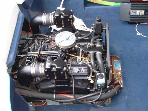

Cuda: yes, I have lots of room around with doghouse removed. Plenty of room to remove damper and cam. My only concern at this time is dropping the front of the oilpan down, just enough to get timing cover out. I believe I can reach all the oil pan bolts but there is not room to get oil pan out to do full gasket replacement.
Here is a pic:
Here is a pic:
dont loosen the pan at all to r&i the timing cover for a cam swap. you just need to put on a new timing cover gskt and rtv the corners. use a screw driver to pry the timing cover down to line it up with the 2 locating studs. i've done several bbc and sbc engines this way. no problems, no leaks.

Originally Posted by cuda
Are you going to try to change the cam without pulling the engine???
I actually was able to in my boat,I had to raise the front about an inch to clear the floor,I remoed the rear bench seat to make room,I also had to take out all but the back 4 oil pan bolts to drop the pan a little,it was not easy buy I did it!!
Here is a pic:
Oil pan should be a one piece gasket,I dropeed mine at the front doing a cam and just bolted it back up.
For me it was easier to drop the pan some,I had a hard time trying to get the timing cover sealed at the bottom without doing it,I have done it without dropping the pan but it was way easier to just drop it and make sure it was a good seal.
