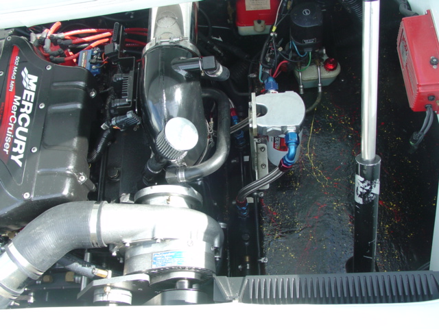

I'm thinking about getting a Procharger M3 kit but I'm worried about the clearance for my Eickerts. Does anyone know if the M3 will fit with Eickerts or CMI sport tubes?

From what I can see no way possible. I had to shorten the airhorn and take 1/3 of the inlet filter screen off my m-3 to clear my stainless marine hi tq 3's,not something I really wanted to do!!!It looks like your maniifolds are much further forward than my risers,I'll post pics and you be the judge,Smitty

from the looks of it, the only choice I would have is a custom bracket that will push the blower farther out so the air horn would be on the outside of the header.
