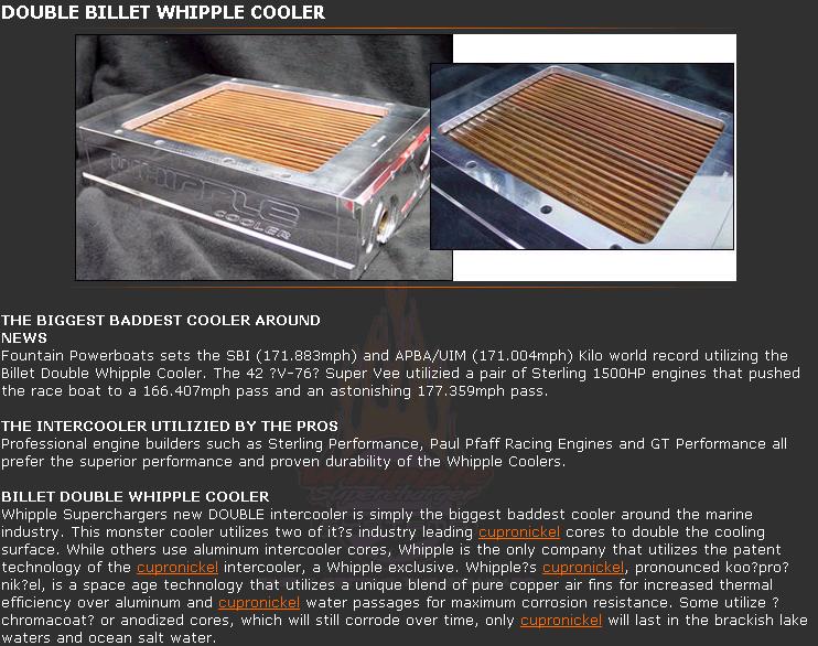

Default Re: Melting Intercoolers
Originally Posted by johnnyoffshore
So who would you say makes a better intercooler for a roots blower that is carbureted? KE? SuperChiller? TheBlowerShop? Who?
I would run the cupranickel cores KE's and whipples got them.
The baddest Intercooler is the Whipple MOAC.
It stands for Mother of All Coolers
Real Wide in the hips
Originally Posted by bob
Knot-right, KE did some comparitive tests on his dyno a while back. You might give him a call and see if he would share with you the differences he saw. I think his package may be hard to beat.
Actualy I have had several conversations with KE over the last few days in regards to the intercooling plumbing.
I was told he dedicates a single stage of the water pump to the intercooler to run at all times.
I stand with the whipple.
KNOT-RIGHT is offline
