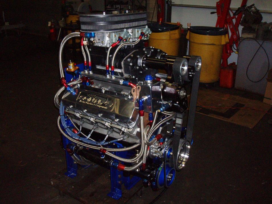

dude junk the stat.
i have installed over 200 high horsepower bigf blocks, none of which had stats. these engines where built by such greats as Richie Zul, Sonny Leonard, Sterling, J.C Performance, M.E.R Performance.
additionally steam pockets will only form if there is no restriction in the water system. if you have water pressure more than likely you have restriction.
also the inlet hose is usually 1 1/4 and then you have a 1" dump out of the water neck housing as stated earlier.if there is too much pressure or your concerned of steam pockets than simply install dumps in the rear of the intake and plumb accordingly with supply pressure.
these three are from. J.C , Sonny, and M.E.R
enough with the b.s
do it already
just doi it.
