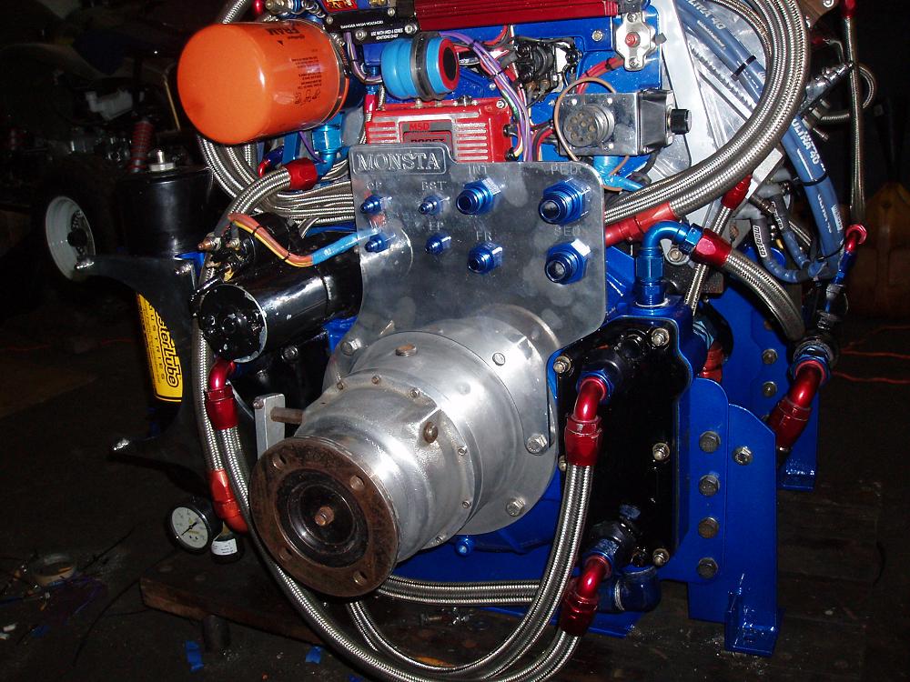

Cuda, right about the 140 thermostat deal; it is because of mineralization/crystallization.
The deal with using NO thermostat is you will run too cold. It acts to restrict the QUANTITY of water, so that the block CAN warm to 140-ish. Maybe not too cold in FLA, or FLA in the summer, I couldn't say, I live quite north; but IF you run with no T-stat and NO circ pump, the pressure in the block WILL be more than the gaskets can take. Instant milkshake following a WOT run, or dyno pull. Watched two buds do this for themselves; I don't need to go there, myself, to see I don't want to. This is where the Merc pressure relief valve dumping overboard, comes in. Merc found this when they used cross-overs on the SC's.
If going away from a stock type water circuit, I STRONGLY SUGGEST using a block mounted water PRESSURE guage.
Monstaaa, as I said, there is no ONE way to do it. If you have success in plumbing YOUR water circuits, that's cool. Your dumping from the back of the intake, and the specific size of that hose reduces the internal block water pressure. But, as I said, there is no ONE way to do anything; if it works for you, fine, no matter what ANYONE says. Do you KNOW what water pressure your systems carry? I have not seen dumps from the rear of the manifold, thanks for sharing.
I'm just an enthusiast, but I've seen a lot of 'steam hose' plumbed boat and race car motors. Most AM intakes have the ports, or at least the bosses are cast in for them.
And I don't have ANY subscriptions. I don't pretend anything. I just pay attention, and listen to others. I've found the smartest people aren't very belligerent.

stingray. all the water systems i have plumbed have been set to run no less than 12 psi and no more than 22 psi( spike psi of 25) with the exception of stock monitoring systems that require more. also a stat is a restriction in thw water system at the higher rates of speed boats are going these days.
many bord members have experiencved this problem in 1 of 2 ways ( to sum it up as an average). the repowered and picked up big speed or the installed a shortie imco lower which put there water psi thru the roof . in alot of cases more than 40 pounds. havind no stat, or a crossover will not push out intake or head gaskets. its the increase in the increase in other areas that help this to happen.
which is why i suggested using a pop off vave, prior to the raw water pump to dump excess before it even gets close to the engine. the intake dumps are to regulate.
again my knowledge comes from countless hours of r and d and alot of high speed applications.
