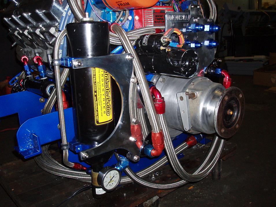

XRP fittings are ok but we've had issues with the anodizing more than once. They tend to use a decorative coating not Hard.
These are the Earls with the light weight reinforced braided hose. Nice chit boy!
