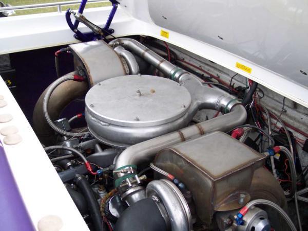

It is possible to run very low compression and high boost. My static compression ratio is under 7:1 and I'm running over 20# of boost. Engine starts making boost at 1500 rpm's so getting on plane is not a problem. I'm using efi and not a blow through or draw through set up.

Check300 - how bout posting a pic!

Not real pretty but It's all home built.

Check300, are details of your engine project available? It looks like there is no intercooler and it is not a Merc EFI system... How fast will it push the boat? I am considering a similar project on a 283 W/ twins but packaging it may be a challenge.

The intercooler is the round piece on top of the engine. The efi is Big Stuff3. The boat runs in the triple digits. With twins you could use smaller turbos but packaging would still not be easy.
