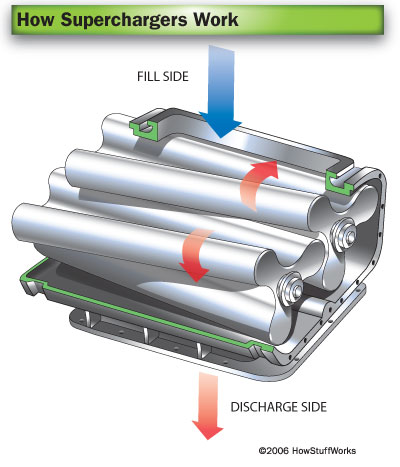

More specific: A roots type (or screw type) has two interlocking screws that force the air charge into the engine and is mounted directly on top of the engine. A centrifugal type is mounted off to the side (like your alternator) and has a fan assembly inside that blows the air charge through some air ducting into the engine. Both types are driven by a belt off the crank.

Roots type:
Attachment 300720

Whipple's are a bit different than a roots type. Here is some good info.
