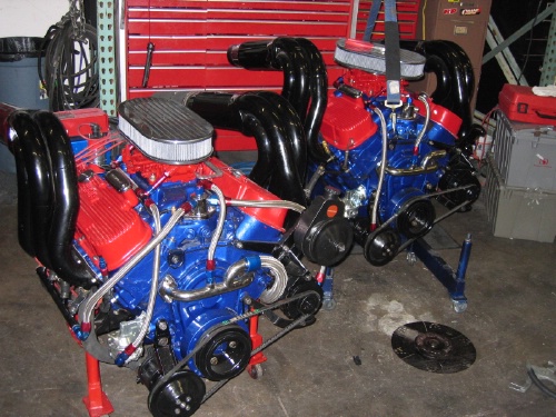

Lightnings.
Attached Thumbnails Lightning Headers-tn_done1.jpg   Lightning Headers-tn_dropin5.jpg   Lightning Headers-tn_dropin6.jpg
