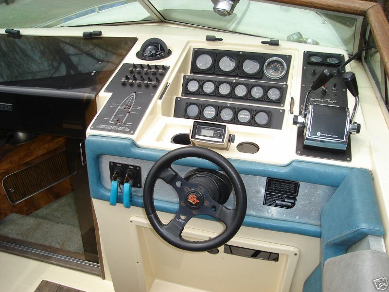

I'm getting a counter rotating lower unit for an older Formula with twin Alpha RH rotation. OK.. the lower units are available, but I have to change the gear shifting to "push", to have it shift in reverse and actually have the correct (LH) rotation. ANy ideas? Any kits around?
Does anyone makes a counter rot. lower unit that does not need shifting switch?? for Alpha 1?
THX . P

Answer is NO !! Ypu have to make the change in the controll box
Correct.
Just connect the shift cable up to the lever
on the opposite side ( from where the cable is currently connected)of the shift lever at the shifter quadrant.

THe shift system is either by Formula or Quicksilver. (older type) Can't be done at the front shifter, I have to do it at the motor. I have to make some home made special reverse bracket or something.

Take a picture of your shifter. Nearly every one can be switched.

Actually I think it is how the thrust bearings are put in the lower unit for a CR one. That being said, if you have the Quicksilver shifter, you should be able to switch it without a whole lot of hassle. I switched the one on my Stinger in less than an hour including adjustment. It's not that bad of a job at all. Does your shifter look like mine in the picture?
PS---you will love the difference in how the boat handles after you swap the CR on....

Yup. It looks just like that. I have to start taking it appart and take a closer look.
So what do I do.. take off the cable and turn it around re-installing to push????
Thx. P
Thx. P
The lever that the shift cable attaches to should
have an attachment point ( for the shift cable) on the opposite side of the levers pivot point.
