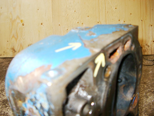

Nasty frozen heads, crummy pix

Freezing
There are limits to what you can weld.
