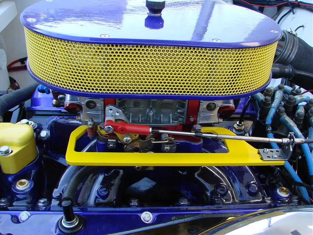

I recently repowered my '97 Baja from my 502 EFI to a HP500 carb motor and I am having an issue with my throttle control. When my motor is at WOT the throttle control is only a little over half way of its range. Is there an adjustment I can make to cure this? The controls are the original Keikhaffer and when I pulled them out I did not see any way to adjust the cable. Anyone had a similar issue? I am reinstalling the 502 EFI after it is rebuilt so I can live with the issue, but i would like to have my full range of movement in the throttle. Thanks in advance!

I think that the EFI motor linkage did not have a long stroke range that you need for your carb. I think you have to adjust it at your levers. You have to move the cable down on the lever for more stroke
Your throttle does not have any adjustment for the amount of throw it has. You have to move the cable connection farther out on the carb. There are multiple holes in the carb. You should probably be in the outermost hole. If it is a very large hole in the carb linkage, then you need to install some bushings to reduce the size of the hole. Holley makes some brass bushings to reduce that hole to 5/16" I think. The farther out on the arm of the carb you go, the more movement in the throttle you will have. Hope this helps, Eddie.

If you can, take a pic of the carb linkage and post it here. Something is not right. You should have full range of travel with the cable in the outermost hole on the carb.
I have seen carb linkages cut off to shorten them. Just a guess as to what may be wrong. Post a pic so I can see what you are dealing with. Or you could email it to me at [email protected].
