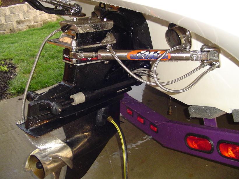

Here is a pic of the Mayfair single ram add on I installed a couple of months ago. There is a clearance issue with the swim platform on my Nordic but nothing that can taken care of.
