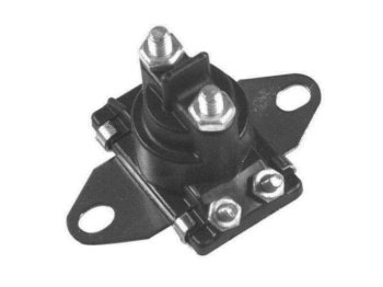

mercruiserparts.com shows the 454 mag slave solenoid mounted on the bracket that the ignition module and the main 50 amp circuit breaker is mounted(looks like the bracket attaches to one of the cylinder heads. Here is a pic, it is not the same as the starter solenoid, the slave solenoid provides power to actuate the starter solenoid and then the starter motor.

Short across the two big poles on the top of the solenoid with a screw driver or a big jumper wire and the motor should start turning over.

Thanks, and I appreciate the picture, makes things MUCH easier to find and understand
