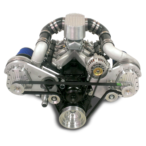

Default You said twin? You can’t put two superchargers in something dude unless it has two mo
Originally Posted by t500hps
I bought my boat with twin 500EFI Procharged motors....M3SC at 8 PSI. They were reported to make 830hp, I talked to a shop that had set up a number of them on a dyno and claimed they would see about 790 out of that set-up....no way 5 PSI is making over 700 hp.
If you really spend the money to set each one up properly both should be reliable......this means putting the motor on a dyno and having it tuned properly....I also believe that the Procharger setup will take them longer to set up correctly.
If you just bolt this stuf on and run it.....chances are the Procharger will grenade you motor twice as fast as the Whipple (might take a few years, but will hapen faster)
you said twin? Are you talking about twin turbo? Cause I don’t think you can put two superchargers on something dude. You can put a supercharger and a turbo. It’s called twin charged when it has both. BMW has done it before. Then they have twin turbo which is two turbos.
Whipple has been doing it for 20yrs, dude. And Torqustorm does it.
