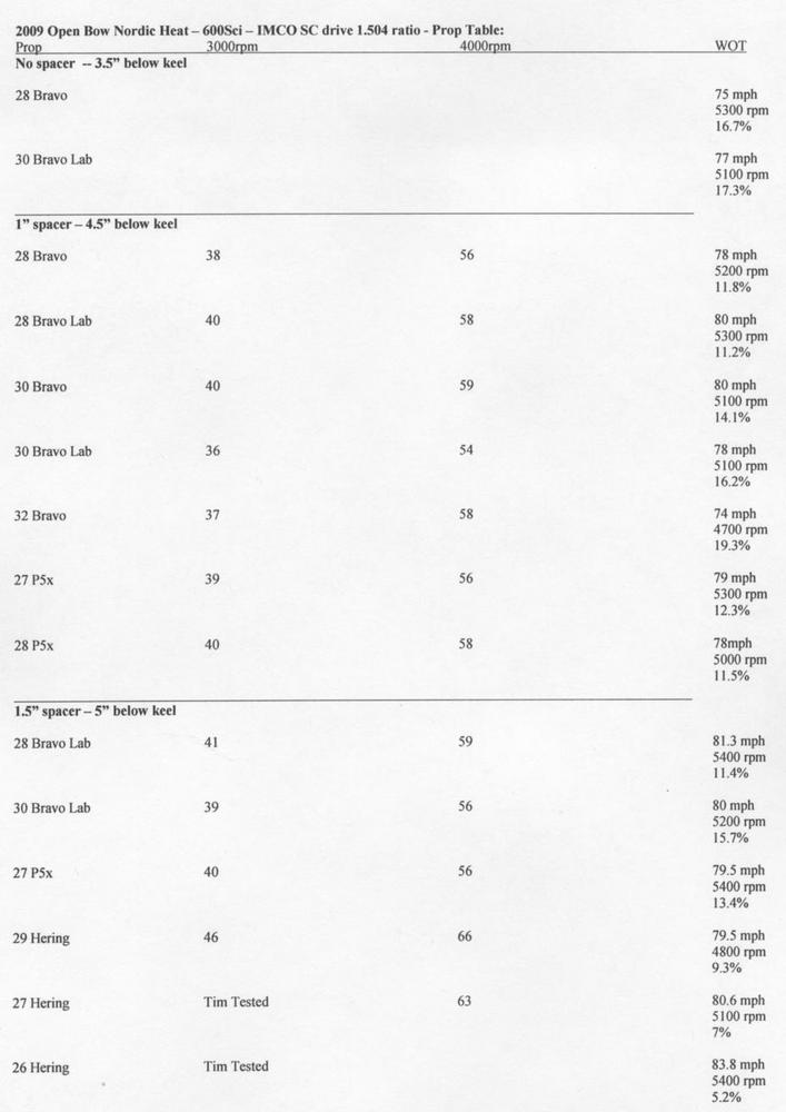

I am now worried about the durability of my IMCO SC drive.
I have an 09 Nordic Heat with a 600sci that I have been doing prop and spacer testing for the last 6 months. Below is the table of my results. These are real slip numbers. Tach has been verified with a digital tach, and speeds with my analog GPS, my digital GPS and a radar gun.
The current best prop is a Hering 26 pitch, 5 blade bravo style prop. Slip is coming in at 5.2%

Prop= 26 pitch Hering 5 blade bravo style prop
Speed= 83.8 mph
RPM= 5400rpm -- On the rev limiter
Speed= 83.8 mph
