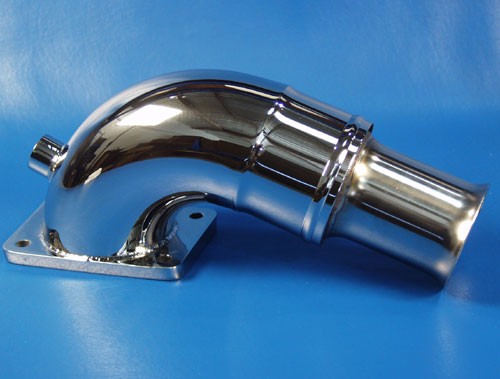

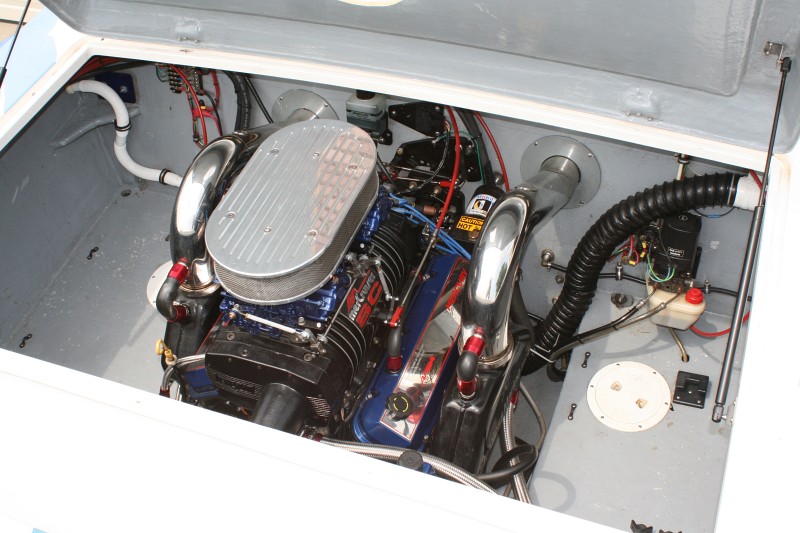

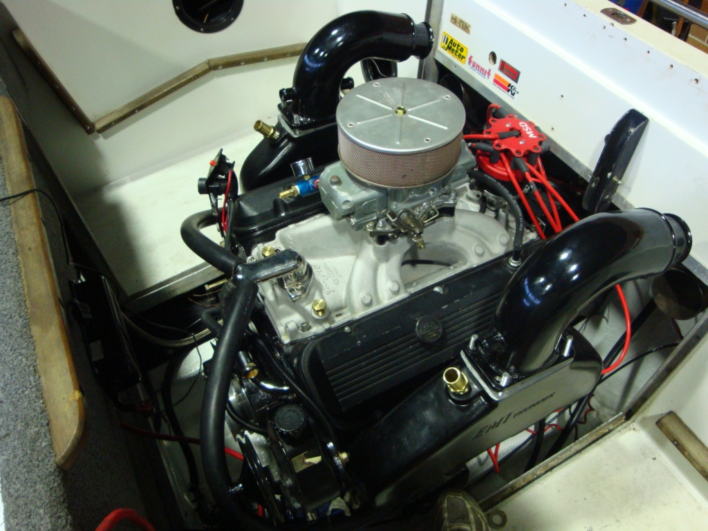

Risers are a combination of height and diameter. The best sort would be the high rising long tail length ones as they would have the highest flowing bend and the latest mixing exhaust and water, but they don't always fit under your hatch (as I found out the hard way), the next best ones would be the low rising bend with the long tail pipe which still has a smooth bend with less rise and the long tail pipe helps stop the water getting back up the exhaust passage and into the heads as it mixes further away.
Heres some pics: (the green ones are cast aftermarket EMI Risers, don't laugh, I think they look great! )

Good example long, medium and short
