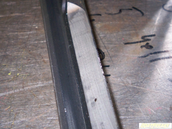

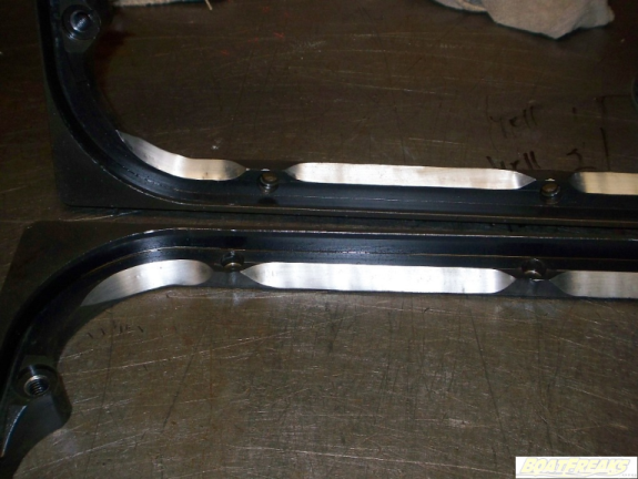

You need to machine the flange so that the oil drains back down and doesn't collect. There was a guy on Boatfreaks that had the same problem, machined the lip and fixed it.

The rails were manufactored with incorrect tolerences for a period when KE did not have control over Quality ..... There are some of the defective rails in Circulation ...m
