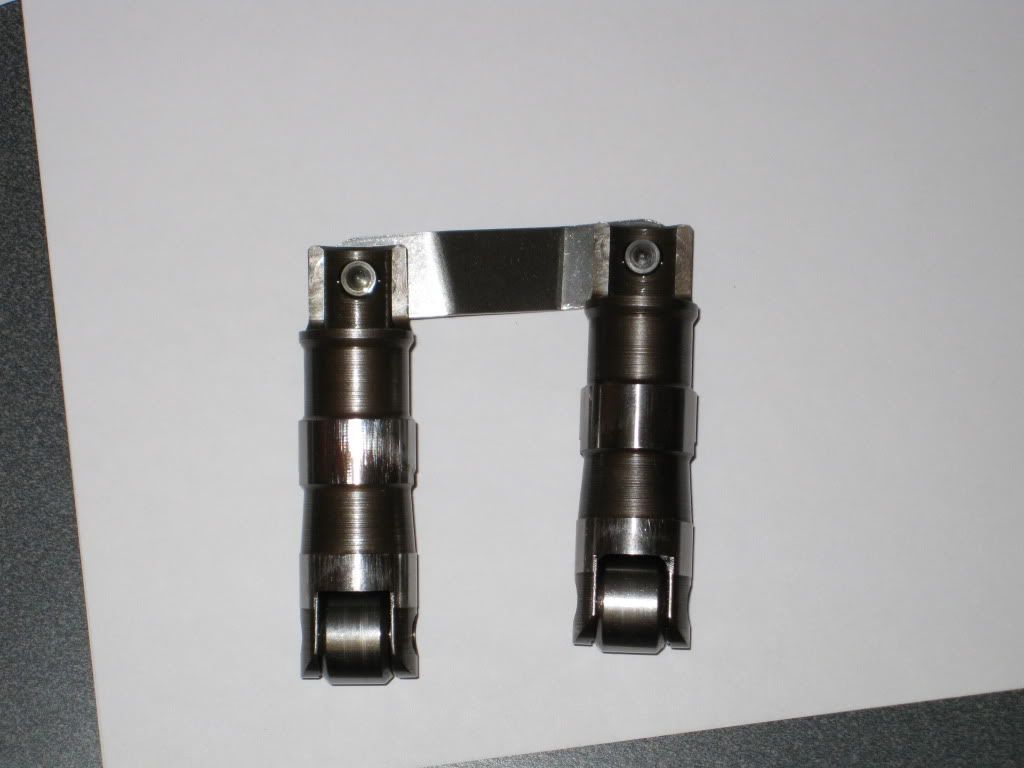

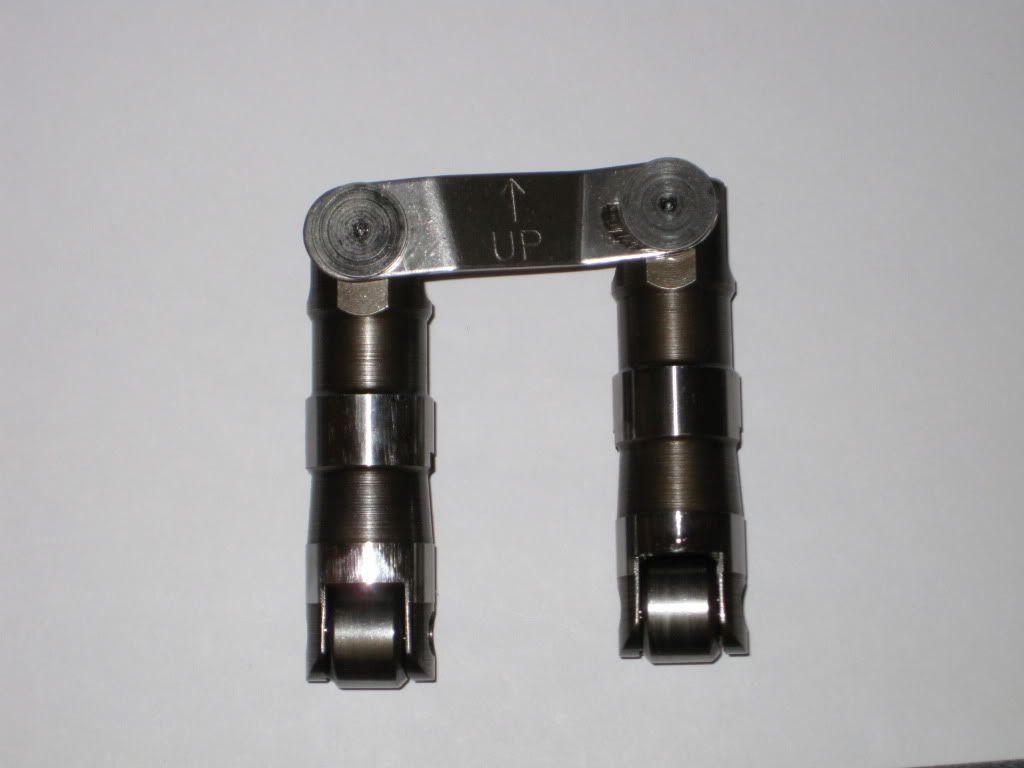

Thanks for the reply Ghostrider, The pan I found out will work. The cam is a crane 771, it will work with the gen 6 block. I think the lifter are useable too. Here is a link, but I believe they are the deep lifters from crane useable on the gen 6. Here are pics if anyone knows.
http://i968.photobucket.com/albums/a...1/IMG_0335.jpg
http://i968.photobucket.com/albums/a...1/IMG_0336.jpg
