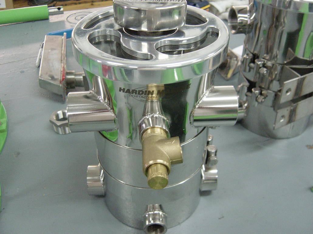

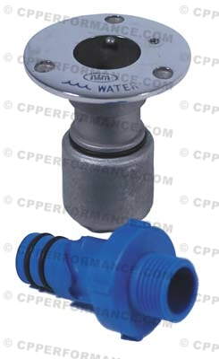

Thanks for the reply, We just installed the motors and drives, MY sports masters are 1" shorter not longer, I have been carefull not to exceed the temps, oil temp is good when engines are @ 140 but when it climbes the oil temp climbes too. Here are what the strainers looks like I'm useing two of them and my flush kit. When I hook the water hose up to run the engines the hose doesn't collaps like it did on another boat I had with strainer. Like its not sucking to hard. I thought my flush kit might be sucking air so I by-passed it and it does the same thing not sucking hard so I hooked it back up.
