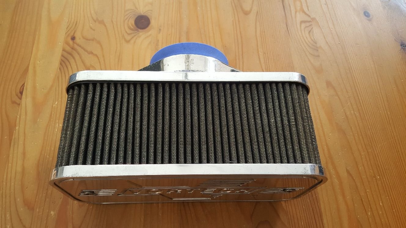

Look great, where did you get the coolant reservoir cover and air filter ?

aitfilter was one from VORTECH,but i think they dont make it any longer.I have not sold with the engine and can sell,but need 250 dollar for it!
