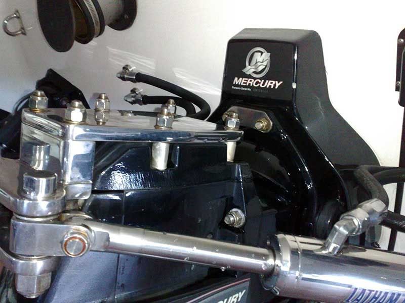

It could be item 12, but it's not easy to tell because I never had to remove the Latham plate, and I don't know if there is any other version which is similar.
Maybe this pic is sufficient to confirm, for someone who knows the various types available better than myself? Thanks in advance!

You've got the "good" one Mr Gadgets was talking about.

Yes thats the fancy one
And thanks for posting that picture.
I just bought a set of those caps and am putting them
on my old style XR's ( with the old style cap)
and was wondering about some clearance issues
with the top plate, that pic. shows me what I'll need to do.

Thanks all for the reassurance! Makes me less concerned about my l/h prop setup.
Btw the boat is now perfectly balanced, so aside from the cost of a new prop I was fearing that she would have listed to port badly with a r/h prop...
@JaayTeee: I have some other pics of the drive, if they can be of any use, just ask. This is the one where the cap and plate can be seen better, though.

Do you have the same Latham steering he posted? I did and had a machine shop take 5/8 stainless rod and drill 3/8 holes through it....then cut it to proper length making solid spacers that bridge over the new finned caps. I then had to take stainless rod and make longer "bolts" so that these spacers could be used. I spent over $200 having all that made.....I have some extras and assuming I can find 2 complete sets are you interested in buying this stuff?
Not exactly the same...mine has the top
plate used with stellings boxes ( with the steering ram
attachment on the side) but the mounting points are the same.
Let me know what you have.
