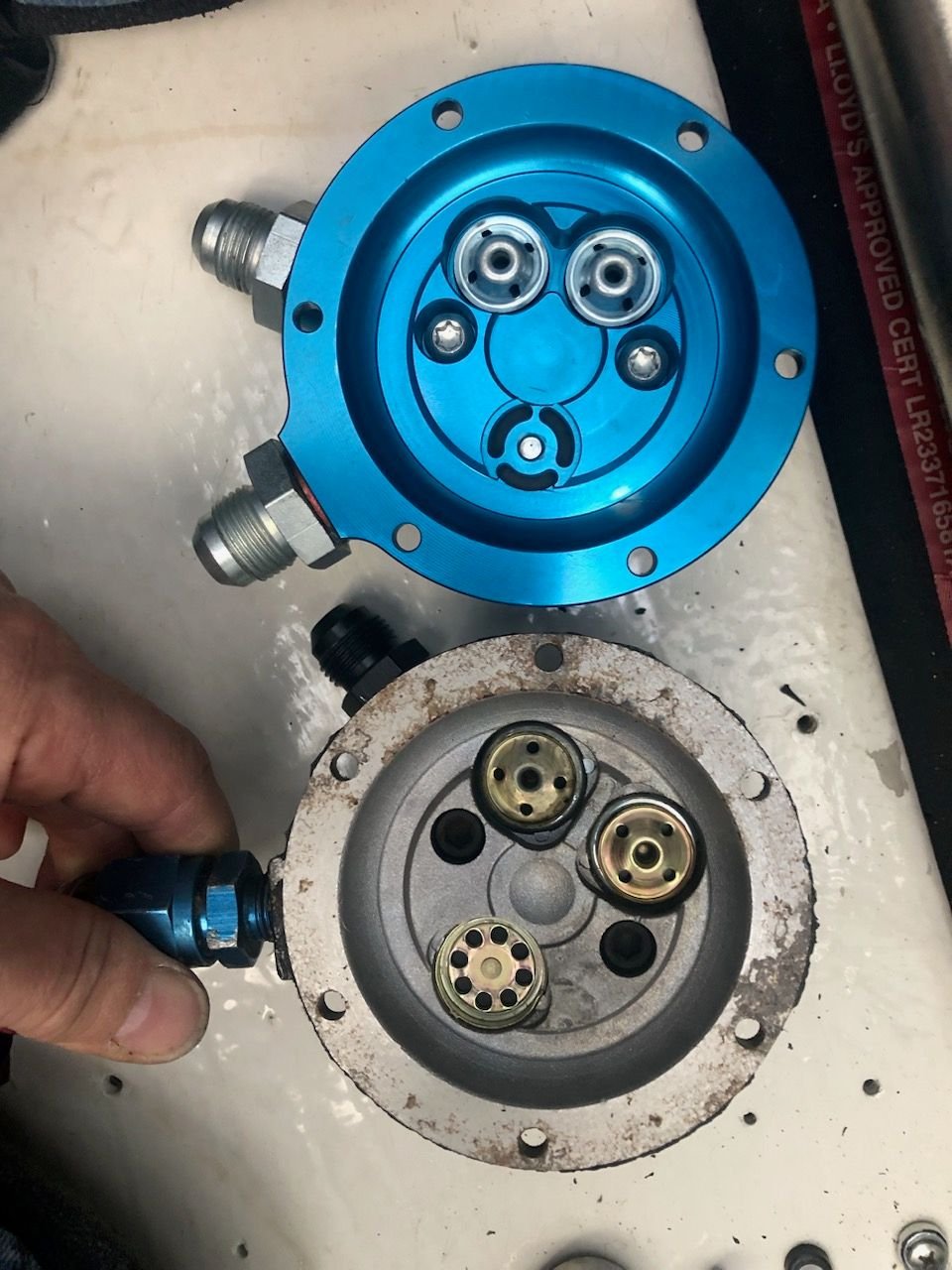

Don't see much difference between the Keith Eickert fuel pump upgrade VS. the stock merc pump. Only difference is the OEM 1/4" NPT inlet/outlet and KE has 3/8" NPT.

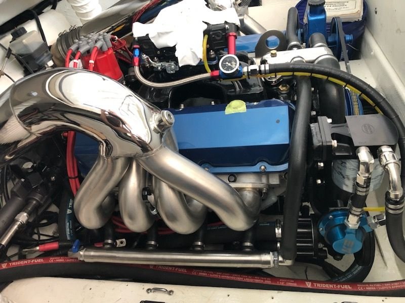

Fuel system I ended up with. I know 90* bends are frowned upon, but I had no choice. I cannot spin the fuel filter head 90* because it would interfere with my battery. I'm hoping being AN 10 from tank to separator and AN 8 from separator to carb "T" helps a little.
