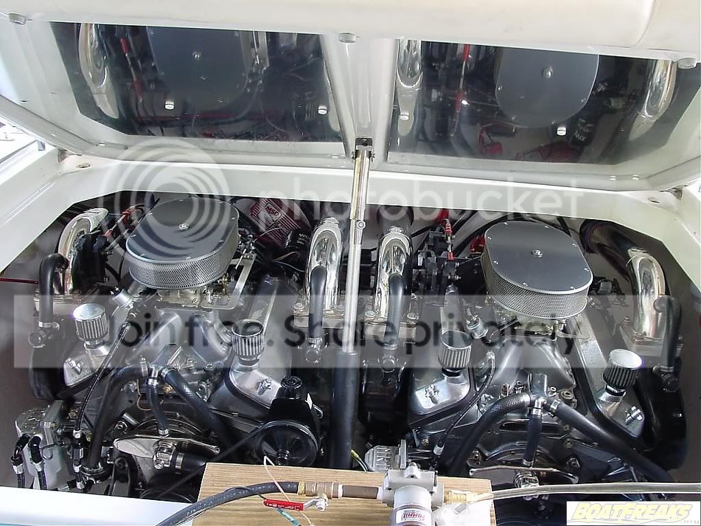

I'm running the Holley Marine 110GPH .... runs 7-8 lbs no regulator .....runs perfect ... 600hp 496's
no regulator needed ....
