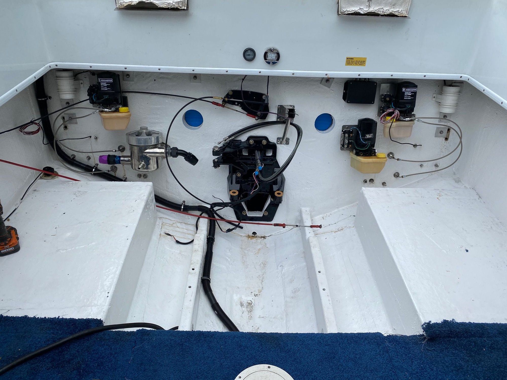

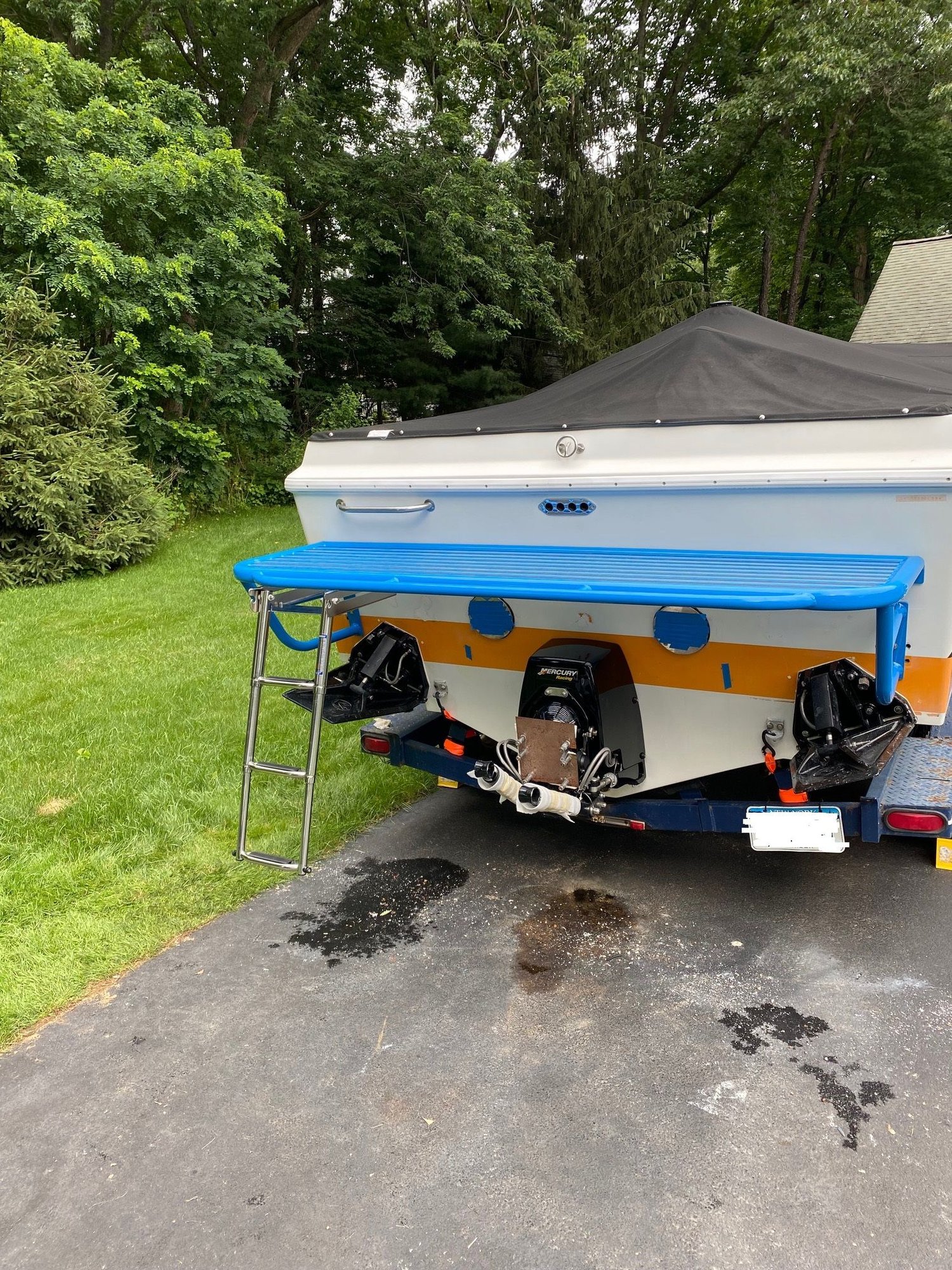

Big_Baller 07-12-2021 09:17 AM
figured I would post up placement of my tabs / pumps incase it is useful to someone else in the future. 1994 24' Baja Outlaw
