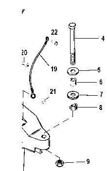

Default flyweel pins
The pin, washer and spacer you need to pull out from the top, when you pull the motor there is a spring and composit washer sandwitched in the back. The nut is held in the gimbal by a slot and small shelf.
