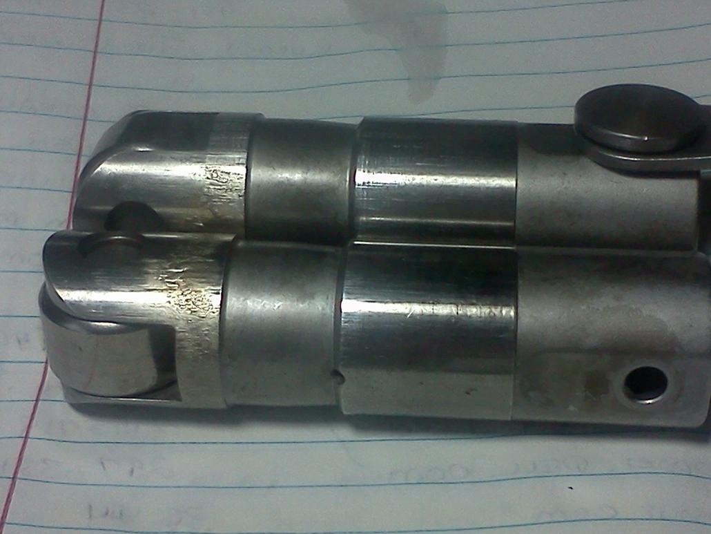

Bushed lifter bores are not a necessity in either a hydraulic or mechanical lifter scenario. What is critical is proper lifter to bore clearance. Next to compliance and lack stiffness in the valve train, improper lifter to bore clearance is responsible for more lifter failures than any other oversight. Too little clearance, you stick a lifter in a bore. Too much clearance, and lifter suffers from lack of support in the bore, excessive side loading, and 16 major oil leaks into the oiling system. Using a bushing will salvage a block that has excessive clearance or erratic bore concentricity.

I think many people overlook, the lifter bores. A micrometer and a dial bore gauge are a must for this job. Either a new block or a used block, it should be checked. 2 ways of fixing it; 1 with lifter truing the block with bushings or same tooling going to a .902 lifter or larger.
Most people, do not want to spend the $$$ since there wasn't a catastrophic failure before with a lifter, the issue is ignored. It would be the same as putting a engine together without checking bearing clearances.I myself use a BHJ fixture for this in my mill which has different tooling and setup fixtures, that pertain to specific blocks and deck heights.
As Bob, stated; 16 oil leaks. Those 16 oil leaks are going to affect the oil supply to the lifter and more so, using a hydraulic or a Hi Rev hydraulic lifter, that will further translate into lack of oil supply to rocker arms and cooling of valve springs.
