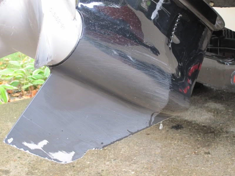

Hey guys, just curious what you might recommend to fix this skeg. I really don't want a Stainless guard...

Look under prop repair and there is always someone who fixes skegs on the boat, locally we got a guy named STANGES prop repair, he welded mine on the boat for about 75 or 100$ 6 or 7 years ago, it can be done , on the boat and no it doesn't burn the oil or bearings in the lower. The guy I mentioned is in Bay city Mi, would be 120 miles from you but I am sure you can find someone locally, Smitty

That's not that bad at all. Should be an easy fix at a prop shop.

Yeah, I just bought it and wanted to make it look nice. The prop is beat up too. What should you expect to pay for a prop job?

I have used Marine Tex to fill small voids like the one you show.

I would have the prop shaft inspected as well. Does the up trim work?

yes...

Just take it to anyplace that welds aluminum. They should be able to fill that in easily.
