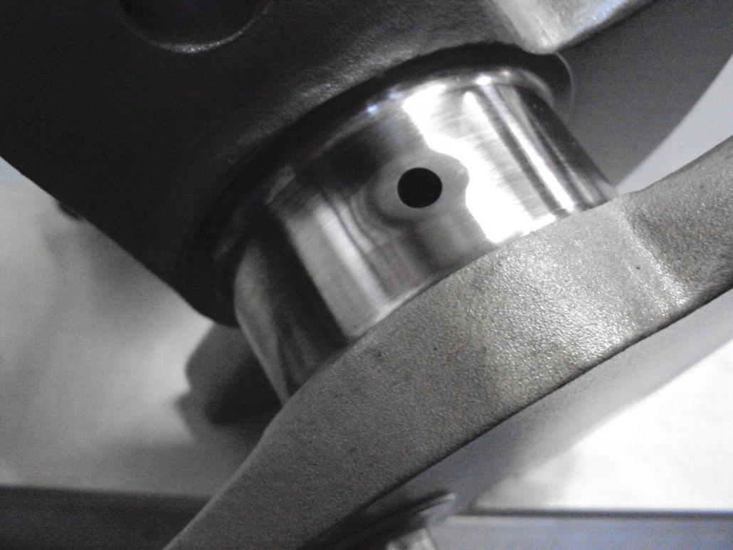

Here is the crank. Notice anything not normal?

The journals on the crank aren't burned up - couple more pictures added.
This isn't just one motor - both motors are exactly the same.

It is most definitley an oiling issue, caused by a modification to the crank.
Did anyone notice the troughs ground into the journals at the oiling holes?
I didn't assemble these, certainly didn't pay for plasti-gage assembly.
The real problem is this isn't where it ends. I am working on more pictures to show what else was found.
I noticed them, and from what I recall, the oil holes need to have the edges relieved back, but in an circular pattern not too much larger than the hole itself.
