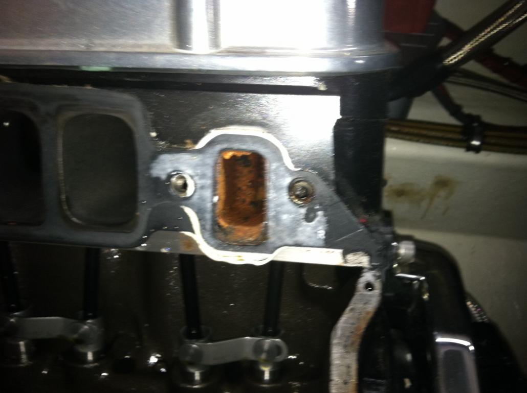

Moving on here are pictures of after the one time we took it to 5000rpm. Oil blowing out of the seal at the rear china wall. Left the paint on china wall and the sealant never bonded. Paint peeled off and leak started. Talk about surprised.
Attached Thumbnails 540 Issues-photo18.jpg   540 Issues-photo19.jpg   540 Issues-photo20.jpg
