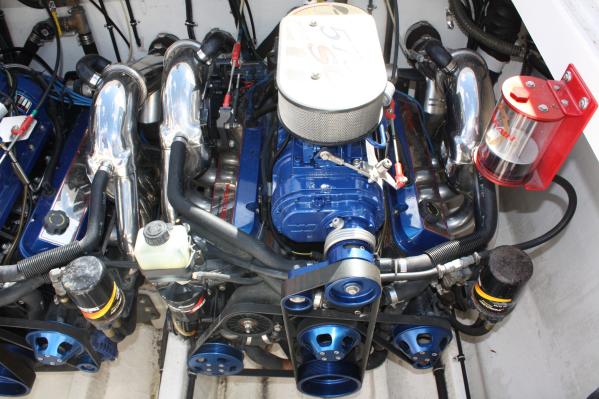

Yes, going to do a top to bottom inspection. They run great on the hose, and you can still see yourself in the merc blue paint. Hoping for trouble free operation, but you never know.
Aside from ten years of dirt in the bottom of the bilge, they look pretty good :D
Attachment 469129
