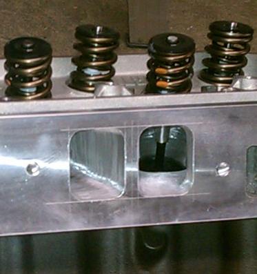

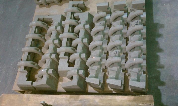

Originally Posted by triple 300s
What size heads and cam did you use? that is a lot of power...
The cam is similar maybe a little more aggressive than the 741.
The heads are a JimV's own hand port design head that Dart cast for him using their base 345 Pro1's. I believe they are about 330cc intake runners. I also run these on my NA 454's and will be adding B&M 250's next winter. Here are some pics of when Jim and I went to the foundry the day they cast them. It was a neat experience, something you don't get to do every day.
