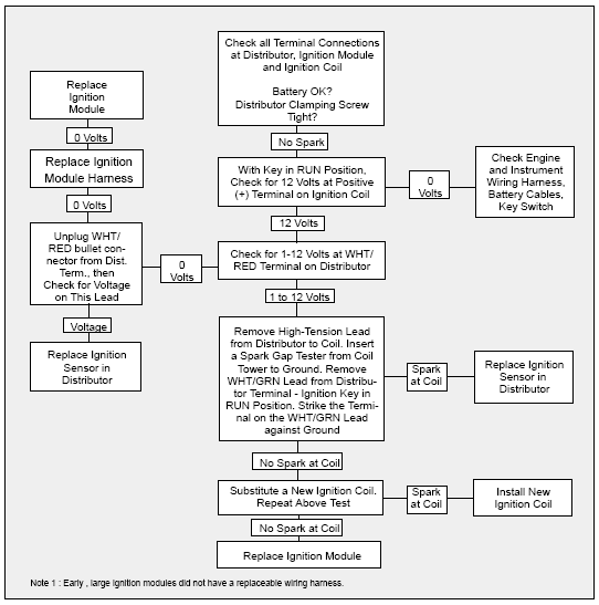

seems elect to me...if were fuel would surge before shuts off I would think...the fuel pressure will show that...all the 525SC's I've seen had a factory fuel pressure gauge...I would try the module...heating up then shutting off....seen that before..also not sure what coil you used but some don't play well with others...MSD sells some drag race only coils that will overheat after longer running...

I just had this problem on one of mine. The best way to diagnose it is to use the Mercury flow chart. That is how I found that the pickup in the distributor was bad in mine.
Remember, you have to work your way through the flow chart when the boat is not running. If you wait until the boat is running again you are trying to diagnose a problem that is no longer a problem....if that makes sense.

Thank you. I will take this out and follow the chart.
