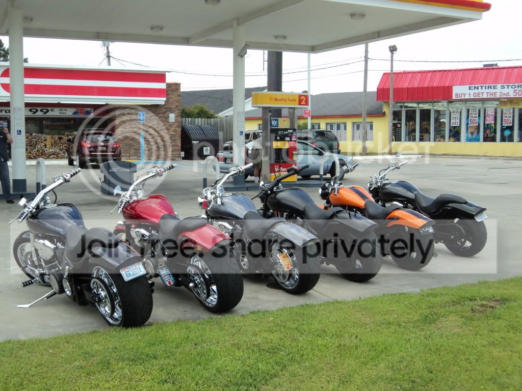

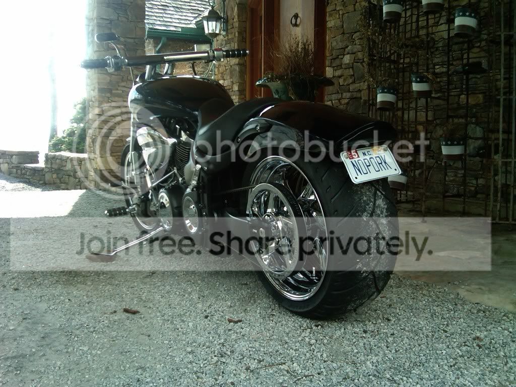

I used it on the tail of my Warrior. First time around it was a little too dark for my liking...so a couple weeks later I wiped it off with lacquer thinner and re-applied. The pic with 4 Warriors has 3 tinted with nite shade and one is a smoked lens. The pic with 6 bikes shows two bike that have original tail lights. Mine has been through a lot...burn outs at the track and burn outs off the track...caked with hot rubber...still looks great!
