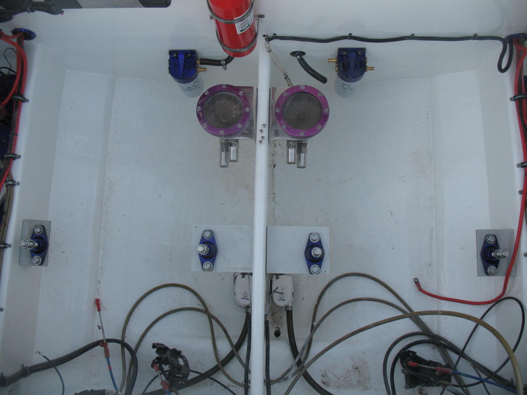

I had a problem with one of my engines getting hot a few years ago, took the boat in for warranty & they replaced a sea pump & said it was fixed. It immediatly got hot under a load so I took it back. They could not find anything wrong so I reverse flushed the cooling system. Problem solved until I picked up some junk in the same engine again. I boat on the Missouri river & it is pretty dirty, I installed sea strainers two years ago & never had any problems since. Another advantage is that you can visually see the water flowing through the strainers. Randy
