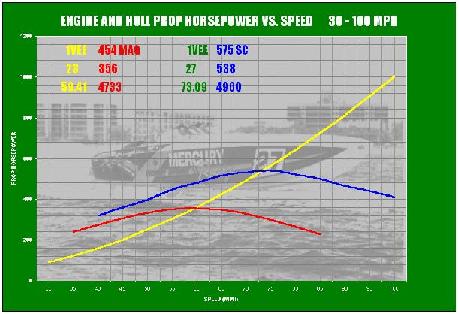

If you use BAM's calculator this hull would fit into Mercury's heavy vee hull/ no steps category. The test data, when adjusted for a believable slip as was done by Mike, give almost the same hull coefficient and slip % as Mercury's heavy vee category. For this kind of hull, in this speed range, the 15 HP per mph is very close.

Now the big question. What prop do I use to get roughly 72-74.......... lets stick with 72mph out of my boat at 5300 rpm. Thats where the motor makes peek power.

In the simulation above I used a HP curve from Dyno 2000, but I made a mistake and didn't build the engine for 600 crank HP @ 5300 RPM. So I added a little more cam and ran another simulation. The best prop was 27" pitch but at only 5100 RPM. If a real 575 SC peaks at 5300 you might expect to use a little less pitch. Or, to turn the problem around, you could raise the drive to reduce drag instead. Then the boat can go faster and the 27 Mirage would run up to 5300. Now you can go 78 mph!

MIlkshake is not a good thing. Where was the oil level on the dipstick? (How much water leaked in?) Don't just look at the dipstick, drain some oil out of the pan too. If the level is up and its all milkshake, you have an engine repair to do. Head gasket at the least, cracked cylinder wall at the worst. Then again, maybe you're just seeing a little condensation on the dipstick. This could be from running the engine cold and never getting the oil temperature up enough to boil off the water. Or it could be a leak inside the exhaust being sucked back into a cylinder at idle, which never shows much water in the oil, but eventually makes the exhaust valves brittle. If the valve head falls off... hole in piston, crack in cylinder, crankcase full of milkshake.
There's lots of reasons why the engine may not be making full power, an overfilled crankcase being just one of them. If you do get the engine back to normal, I would definitely be trying 3 blade props. Check your X dimension. If the propshaft is more than 6-7 inches under the hull, you don't need and can't use a four blade for best top speed. If the boat blows out just a bit in turns or when planing with a load, then the three blades are submerged enough to give you all the blade area you need. Anything more and you are wasting power turning extra blade area. The extra blade does give you better acceleration and lower cruising RPM if that's what you're after.
Using your test data with the 24 four blade (and the full load and smooth water) gives a less efficient hull curve, but you should still be seeing about 71 mph @ 5200 RPM, if the engine is right. The only way I can get the results to fit the curve is if your engine is only delivering about 475 HP to the prop. How sure are you about the power of this engine? Can you provide a few details about it?
