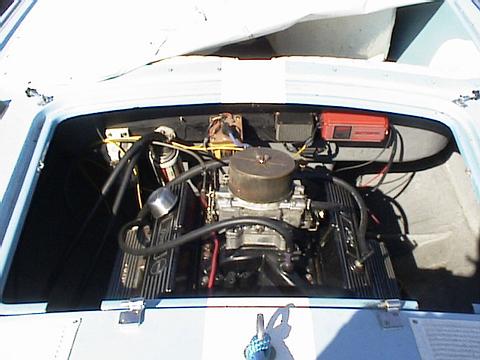

david, there are 3 separate articulation spots for the accelorator pump,
are you thinking its pumpiing to much gas in the motor, and thats why I get that PAP sound?
what about the poping sound when im on plane?
it does it when I keep the throttle in the same position for a long period of time...
anyone else have suggestions?

I know the carb is mech secondaries. There is an air valve similar to the air valve in a Quadra-Jet in the secondary bores that restricts air flow if you open the throttle fast at low rpm's. It functions (opens) when airflow increases sufficiently to pull fuel from the nozzles. There is no accelerator pump in the secondaries, and if you modify the air valve function, you will get a flat spot (bog) or backfire when you open the throttle fast under load.
The rear hose attachment on the carb is for a power brake booster. You are correct about the small line on the fuel pump. It is possible that with your fuel pump vent hose attached to a vacuum source, it may be causing the fuel pump to not work to full capacity and cause low fuel pressure, resulting in a low fuel level in the carb, which can causes a lean mixture, which could cause backfiring thru the carb.
Some of the early Ford small block heads had adjustable rockers vs. non-adjustable. Cam changes (smaller base circles) can create adjustment problems with fixed adj. rockers.

beerock,
If your motor sounds a little funky on the port side , check for a loose or broken rocker or bent pushrod on an exhaust valve. If the exhaust can't get out it will cause a popping on the intake side. Been there , done that more than once . Once was a rocker starting to split and was actually bending back from the split. Another time it was a bent pushrod.
Sometimes there is no other reason but Gremlins in the motor causing these things to happen .

Hey bee,
It's me again, I was just studying yuor picture. What kind of exhaust manifolds are they?? Can't say I've ever seen anything like that in a boat. (and I once owned a Ford too).

there glenwood lceramic coated og style headers
I have been told they restrict HP- about 30-40HP but the only company to make bassanet type headers is CMI and they cost 5000
the glenwoods look really sharp though
