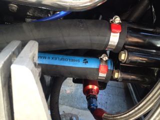

Joined: Jun 2009
Posts: 426
From: Kirkland, WA
Sorry these pics aren't great, mine is installed just aft of the seawater pump. Dumps off the back where I can't really see it, even with the go-pro. It's worked fine like this for quite some time, just seemed like an expensive potential gamble that the blow off valve keeps operating properly-
