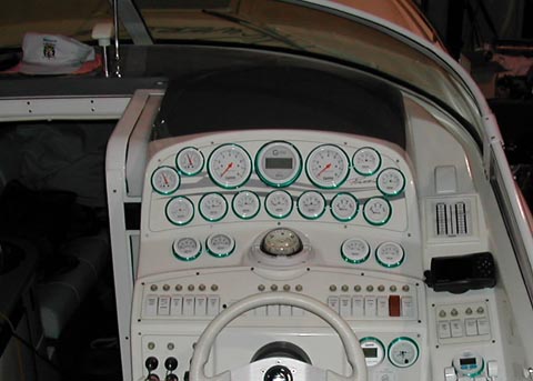

I hooked mine up to my garmin unit and it works fine, You would hook the wire from the sppedo to the "NEMA" output on the GPS. Also both ground for the GPS receiver and the spedo head should be the same too. Some gps's have different settings for this output wire for other equipment, You may have to go in the setup screens to choose NEMA. but I believe the NEMA standard is 4800bps and that is what the GPS speedo use's for data.
I had mine hooked up this way first then I changed back to the full time receiver. My problem was I had to turn on the switch to the Garmin unit and the hold the on button first before it would start to accuire and show MPH. I had bought the whole kit and had the second reciever anyhow.
Garmin has OEM Sensors and the GPS35 is what Gaffrig Perf uses: http://www.garmin.com/oem/
Here is the instruction sheet: http://www.garmin.com/manuals/spec35.pdf
I think I bough one a year ago for a motorhome for about $135.00 from a wholesailer. You could also use the GPS36, it is the same but on a pole and white for marine.
You would use the Black, Red and white wires only. White would go the the GPS Input.
Here is a pict: my existing Garmin gps reciever is on the pole abover the walk way, the "new" one (Garmin from gaffrig) for the speedo I mounted just abouve the trim indicators. They only came in black so I had painted it to match with automotive paint, I just drilled one hole and used sticky tape to hopld it down for now to verify that it worked there. It seems to be fine, If the tape goes bad I will just calk it down.

Be carefull painting GPS antennas, especially white. Most paints these days have metal in them, titanium oxide in whites, which can kill the antenna reception. Be sure to paint a test piece of plastic first and place it over the antenna to be sure it doesn't obstruct the signal.

Yes they will do all that but I had mine mounted down lower and It was hard to read. Where the center guage is it is less destraction from the view ahead. Some of the GPS's you can move the data fields arround and make the numbers bigger.
As for at the paint I used Duplicolor arctic white, it seems to work fine.
