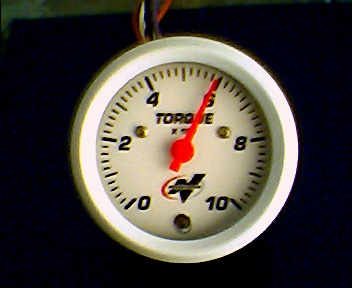

It's almost ready to test on a boat. This is a measuring device to measure the crankshaft TQ, rpm. and HP while on the boat while on the fly. It mounts inside a Bravo 1 Stellings extension box. It's output can go to a datalogger, digital display or a guage.
I had Nordskod build me the guages one is for HP and the other is for TQ. The scale is 0-1000 HP or TQ. They are 2 5/8" white on white. Here is a picture of the TQ guage. As soon as the strain guage is mounted/molded/calibrated I hope to install it on a 32' Skater with 575's and XR's and test it out. Can't wait.

Here's the TQ guage. Bear with me on the picture, I'm still learning this camera/computer thing.

Thanks. The meters also have a push button tattle tale feature so at the end of a run you push a button and the highest reading will show. The resolution is OK with the guage but within 0.1% with a digital voltmeter. I don't know how much interest there will be in it as it has a very limited application and audience, otherwise I have a very expensive toy for myself.
