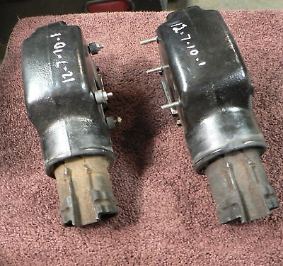

[ATTACH=CONFIG]521781[/ATTACH] these are the elbows that went bad on mine. the inner part just dissolved, allowing the water to pass back into the pistons and into the oil.

I was dead on. I figured it was an exhaust problem of some short. Only because I have been down that road before. Hint, Hint...... You might as well and go ahead and replace the other side as well. Glad your problem has now been resolved.

The merc high performance exhaust he has is entirely different than what you show here. The blue motors do not use a wet joint exhaust. They use gill or cmi with hi rise tails that dump closer to the transom
