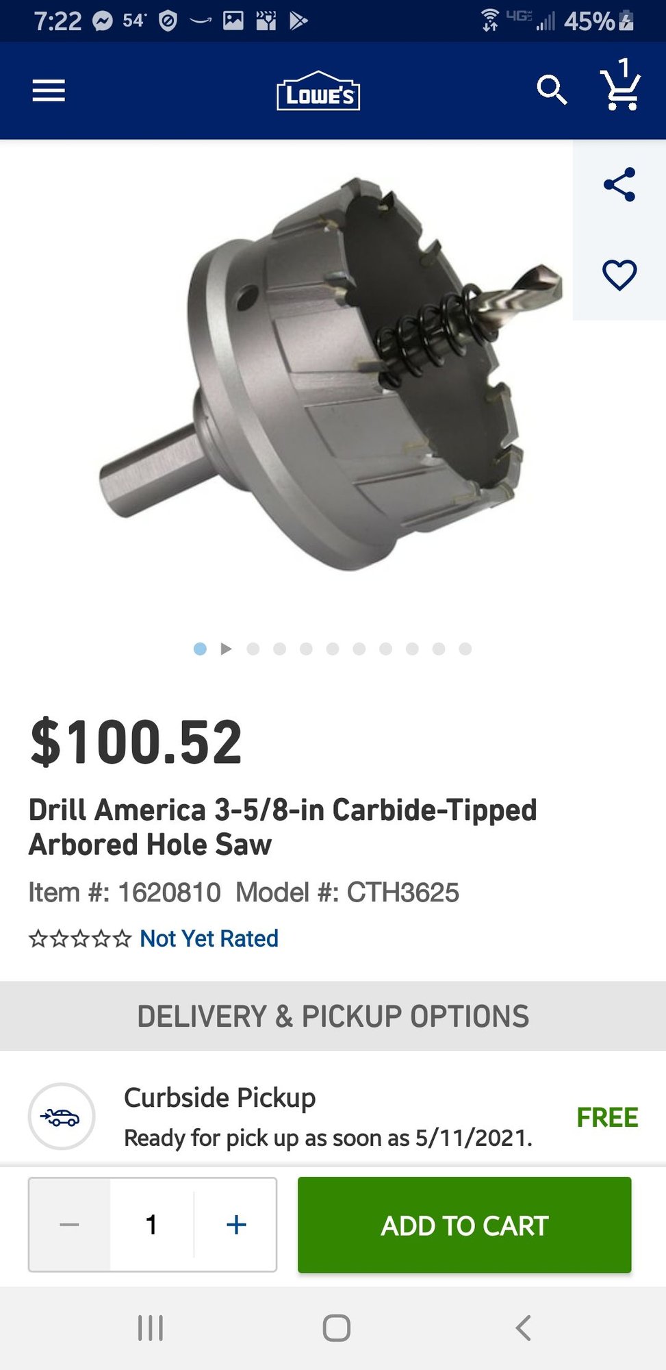

Old 05-03-2021 | 07:08 PM
wwwTOPDJcom's Avatar
Posts: 3,514
From: Vestal/Binghamton NY
Default Faster way this cuts faster
Originally Posted by Got Cigs
Older thread, but wondering if there are any new techniques to gutting these baffled corsa tips?
