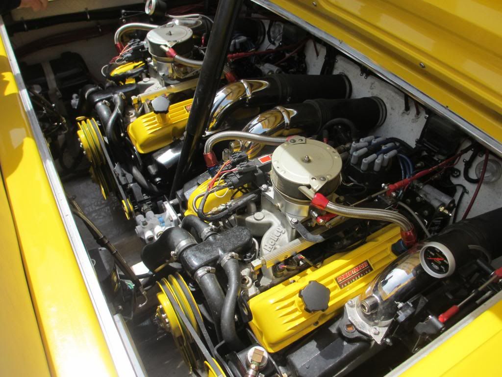

I did not check for spark or pull the plugs as it was getting late and we just put it back on the trailer. It did feel like there was liquid in the cylinders and couldn't compress it. I believe this is the older Holley system. It has a black plastic box mounted on the fuel rail. Hard to see it in this picture, but you may be able to identify it.

If I remember correctly because I have not touched the Hirel / Cutter set up in many years nor seen one in a very long time. If I remember correctly something in their system would shut down - and possible fuel would still flow into the cylinders for a few seconds after the fact. I what to say it was their management system that would shut down but the fuel pump still flow fuel a few seconds on top of. Anyways I have notes somewhere on them but I think it was 15 to 20 years ago.
You know the set up in the pics looks like someone professionally installed it - nice job by them.

Thanks to my buddy Revd Up for posting this thread! I own this P-29, and I sincerely appreciate all of the assistance. BUP, the gentleman in Ohio that installed these engines around year 2000 seemed to have done a nice job. I love these motors, just having a little trouble with one of them. Here is a closer shot of the Holley system.
