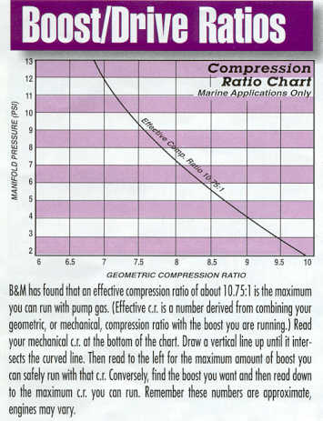

This is a marine motor boost chart from B&M...Its on the conservative side but it shows a basic guide line.
