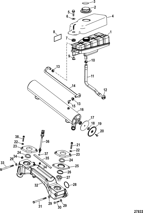

Originally Posted by smokin' gun
Put a new short block in one of my engines last year swapped all necessary parts
525 efi motors also ..in the heat exchanger there is a temp sender somehow in between pulling the old motor and rigging the new motor it went bad .. I could start the motor cold and if I let it run any more than 10 min it would not restart again unless I waited an hr or so .. If I held throttle wide open( clear flood mode ) it would restart after a lot of cranking .. Turns out temp sensor was the only issue .. Motor simply thought it was cold and dumps more fuel even when warm ..they have a new design temp switch .. Early ones were all plastic the replacement is brass. ..u have to remove heat exchanger to get at it
Are you referring to #36 in this diagram? If so, wouldn't SmartCraft detect that the sensor was bad?
[ATTACH=CONFIG]530194[/ATTACH]
http://www.mercruiserparts.com/Show_...tem+Components
HyFive578 is offline

I had the same problem with the engine yesterday... cold start fired right up... ran her for 15 minutes, let sit for 2 hours and it took me 4 turns of the key to get her to fire.. I hooked up a fuel pressure tester yesterday to test the leaky injector theory. Got around 40 psi at idle and it took over 2 hours for the pressure to bleed down to around 16 psi and then I let the pressure out manually. I would think that if the injectors were leaking, the pressure would bleed off much faster than that. I think I will try to replace the temp sensor on the chance that Smokin Gun's theory is right, but any other ideas?
