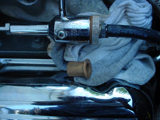

chavvez's Avatar
Posts: 30
From: Oakland Co, MI
How do I clean this? I have not change this filter. Looks to be made from brass.

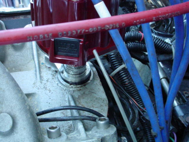

Any one know what the white hard plastic tubing is. Looks like it should go near the distributer somewhere.

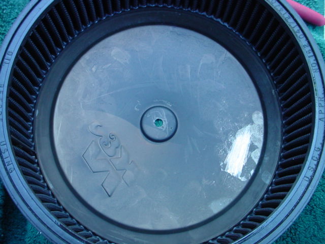

Old 08-31-2002 | 06:46 PM
chavvez's Avatar
Posts: 30
Underside of engine hatch, no more pics. Please help!!!
chavvez is offline
